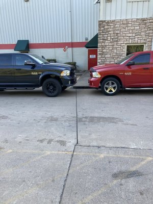

The red is my boss’s -a 14- with 114k all original except front struts runs great D6FB5F05-C082-4540-866E-B7C3CB8F8063.jpeg
