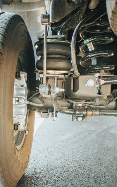

FYI, 2500 & 3500 are FAR from the same. The rear end suspension on a 2500 is a narrow 5 link inboard frame mounted coil springs.
Airbags to assist in stability for any real weight helps alot. Ask any guy that found out the hard way when they put in their slip in camper. Alot of guys will also add a Helwig HD Swaybar to the rear for the sway.
You can see below how far inboard the springs are. They do not have the same ratings as a 3500 leaf spring.

It does not matter what use to be, it is a coil sprung truck exactly like I posted in the picture. There is NO leaf spring heavier duty option. But also note airbags are available for a 2500. Again refer to the picture I posted.
