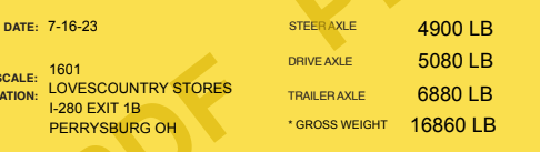

Here is my truck on the scale with two adults and 3 small kids. I have 1660 available payload, and 2800 lbs available on the rear axle.
And here is my most recent weigh with a 33 ft TT. I actually have to be careful not to overload the truck bed with gear, I weighed in once time about 200 lbs over my payload capacity.

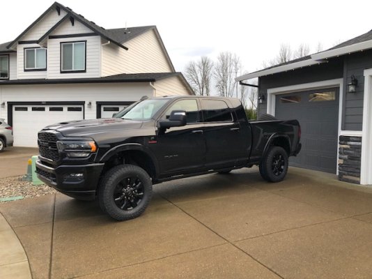

My 2023 2500 4x4 Limited MegaCab CTD payload is just under 1800 pounds. That’s why I will be sticking with a bumper pull RV and not going to a FW. The CTD reduces payload a lot!

My 2023 Limited Mega Cab CTD payload is just under 1800 pounds. That’s why I will be sticking with a bumper pull RV and not going to a FW. The CTD reduces payload a lot!
You said MegaCab, Limited, and CTD all in one sentence. I'm also assuming 4wd... You probably have close to the lowest available payload with that setup. :) Realistically though, that's not a horrible payload considering all the options you have. Is this a 2500 or 3500 SRW? Assuming 2500. If so, the suspension limits your payload as well. My MC Laramie payload is about the same as yours.
