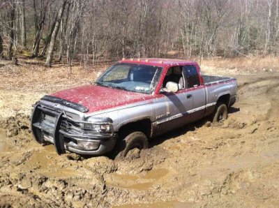

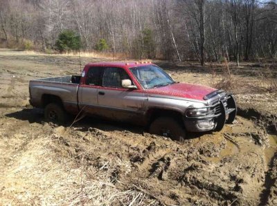

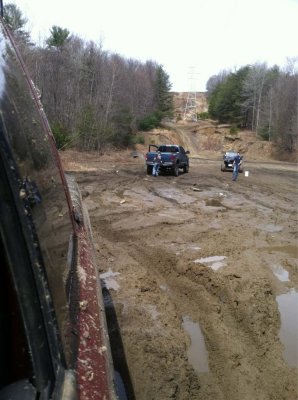

Went out on my own today thinking I wouldn't get stuck because I wasn't doing anything stupid.... I've driven over this section at least 30 times....but snowmelt and 3" of rain last week had other plans.... Lmao.

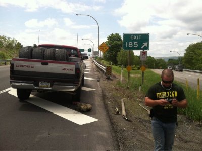

Brothers Ram on the way to work one day,

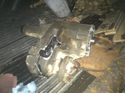

What happens when the tail housing on your transmission breaks off at 75 mph... Catastrophic damage, leading to transmission job #2 within 5 months...

241D and 241HDs were used on the 2500. They'll both bolt right up to the 46RE to my knowledge, but you'll have to get the driveshaft lengths changed.

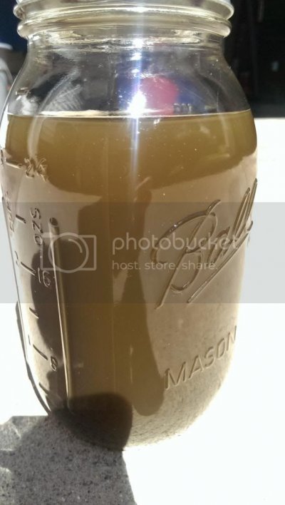

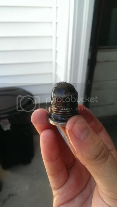

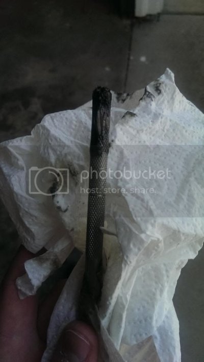

Here is my current broken... Nothing fun though

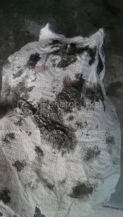

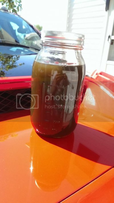

Rear differential fluid at around 2,000 miles/2 months
Dipstick:
Drain Plug/Magnet:
Fluid:

No idea yet... It has a rattling/clunk coming out of the rear differential when I hit bumps/come to a stop. When I checked the fluid, I didn't have time to pull it all apart/diagnose/repair, so until I can research it more and gather some parts, I threw in a new batch of 75W90. The truck still drives fine, just makes noises.
That's fine. The transfer case mangled my rear shaft anyways, and the front one exploded into 6 pieces. Lol
No sir the driveshafts will stay the same length.
OP make sure you get a 241 with the right input spline count and the same input shaft length as there are two opt out there.
Would you do us a favor? Would you remove the tailshaft housing off the xcase and see if the C clip is still in its place.
OP make sure you get a 241 with the right input spline count and the same input shaft length as there are two out opt there.
Okay, I'll have to count what I have now. Thanks for the info!
