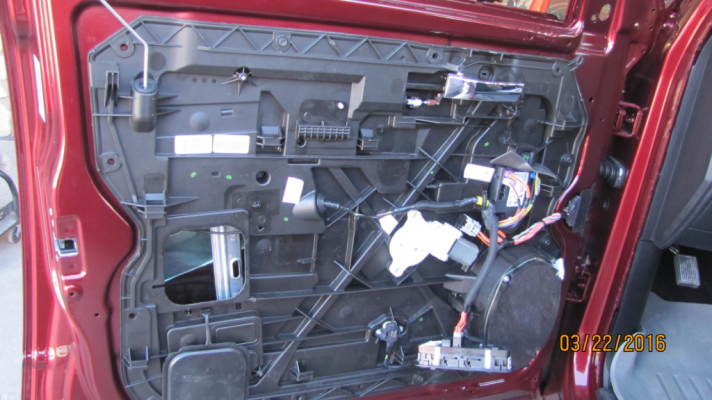

you are going to need a Master Door Switch similar to this one, i don't know what the passenger side switch looks like
you will also need 2 of these, a front left & front right, that work with power folding mirrors
Driver Door Modules
they mount in the door, look for all the wires

When I did mine the wiring was there got the mirrors and the modules and was pretty straight forward plug and play
