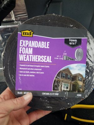

I love my truck, but it is a loud beast. I had went to an audio shop for a quote to sound deaden the truck. $2750 for the ultimate mat, $2300 for the basic. I have the money, and for the amount of labor and materials involved, I don't think that is an outrageous price. However, me being me, I just couldn't help but wonder what it would cost to do it myself. I researched the more popular products, and some of it was in the range of $3.50 a square foot. After reading the SDS and white papers on the materials, I started searching for like kind materials but under different names, locations, etc. Basically all of the materials used are butyl mastic tape with foil facing, foil tape, closed cell foam, spray adhesive and 1lb per sqft mass loaded vinyl (MLV). The hunt was on! Lowes and Wal-Mart had most everything I needed for a fraction of the price, but the MLV was a challenge. Then I realized we use the exact same thing to sound deaden piping system in the plants! A few quiet words here and there, the promise of a six pack, and I acquired a truck load of 2lb per sqft MLV. 128 sqft and twice the density of the name brand stuff for $12 bucks worth of beer.

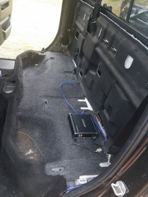

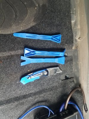

Some very basic tools was all that was needed to get started. I used the Peel&Seal anywhere there was a drum skin. A simple tap test is all I used to find the worst problems. From everything that I read, placement and adhesion are more important than coverage for the first layer. I decided to go for all the above on the back wall.

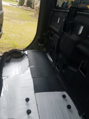

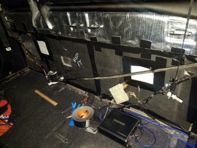

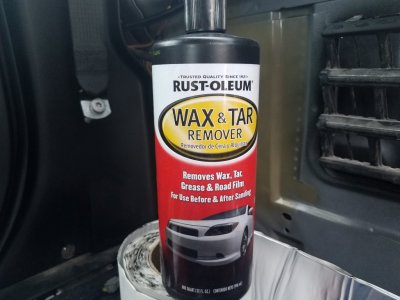

First layer was the butyl dampener. I followed that with a radiant heat barrier.
