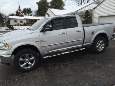

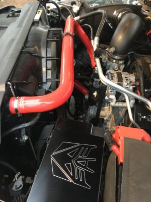

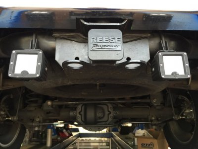

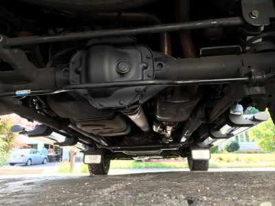

0E24E7BE-A306-462D-94D6-73EB44AC4088.jpeg 10C9ABD5-FF54-437F-9EC1-EF66AFFDFF8F.jpeg 179E00E3-A6FA-4E03-827A-C4EE6402D13A.jpeg A0271AAF-1F85-4442-8ABB-87C0FE62731D.jpeg Yup transmission tune and a pedal commander and hold on! Lol
Then good set of headers ceramic coated with high flow cats and you are good! Stock manifolds are ****.
I also run the magna flow 16869 cat back system with a QTP e-cutout when I want to run it open header!!!
