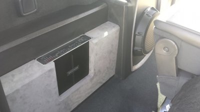

I just got the Kicker 11HS8 Saturday, on sale at Best Buy and most other places right now. Haven't wired it up yet but I slid it under the drivers seat just to be sure it fits and it does. Didn't want to take up the storage tray space behind the seat. It came with what looks like plenty of wire. I ordered new rear speakers as well but they're on backorder. I plan to tap the rear speakers when I have it apart to replace them.

^ That 'ish is bangin'! Nice install! :)

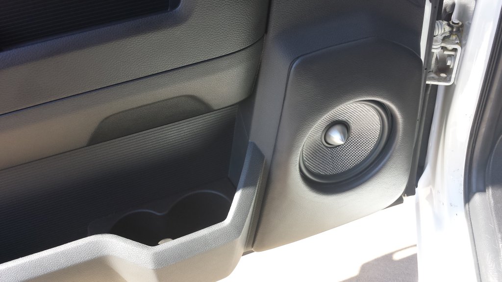

OK, gave up on the 6x9s that were on backorder from crutchfield and got some Kicker 6.5s in the doors and behind the seats, Kicker 3.5s in the dash and the 11HS8 under the drivers seat. Question about the subwoofer for anyone who has any experience with this particular one. When I get everything balanced out and sounding good the sub starts dropping out. Example "Hotel California" on about 25/26 on the stock RA2 5 inch head unit. Input level set to high, base boost at minimum, crossover about midway, gain barely turned up it works ok but if I give it enough gain to start to feel it starts redlighting. I listen to late 60s classic rock and blues up to Guns and Roses. No hip hop. Is this normal or do I have a dud?
