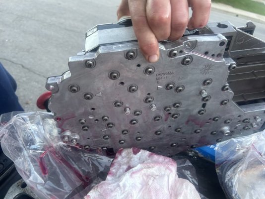

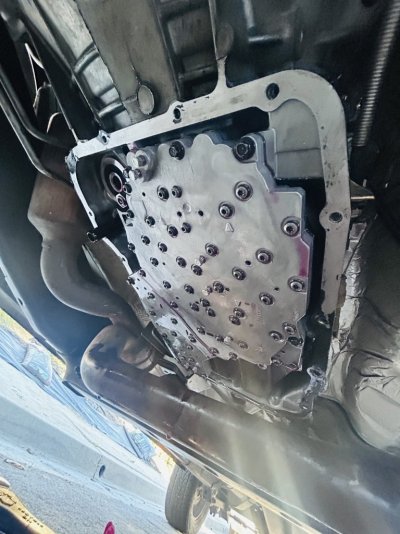

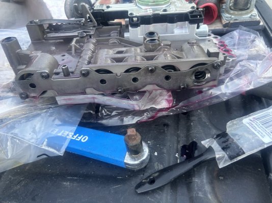

What size, type and torque do I use for my Torx Valve Body Screws that connects my solenoid pack to the valve body? Been getting soo many different responses and figured the ram forum would have the right answer. Can anyone help?
Since you have an RFE transmission, I torque the solenoid pack screws to
50 in/lbs. of torque.
When installing the valve body, the valve body to transmission case bolts are torqued to spec at 105 in/lbs.

I heard that the zf uses aluminum screws for the solenoid pack and they should be replaced. Can they be safely replaced with steel? Not sure. (edited: nevermind, just saw your pictures, you have the 6 speed. New screws not required, I didn't need to when I changed solenoid pack)
