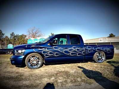

Jesus Christ

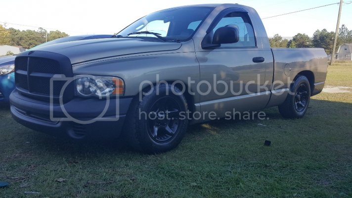

I am gathering the parts to do it right now, but my advice would be to start at 5/7. That'll give you a good idea of the issues you'll have going lower pretty quickly. Mine sits a little higher than normal in this picture because I have air in my helper bags, which helps the ride quality a bit.

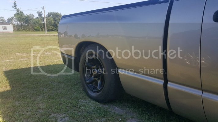

Jesus Christ
Man, taking my rear bumper and that huge bracket along with the spare tire to put the roll pan on really raised the back of my truck up a lot. Even with no air in the bags, mine sits about the same as yours now. Here's the rear with the bags at the minimum 5psi:

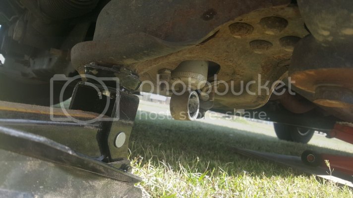

You'll also get to deal with problems like this, which is caused by bottoming the shock out with normal driving on the shortest Belltech shocks actually made for a Ram. The fix for this is a set of expensive QA1 or similar shocks at a custom length..... Even more money to make it perfect.

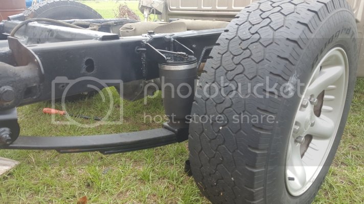

They were just over $300 if you want to use an air hose. I spent an additional $200 to have an on-board compressor, which I haven't mounted yet.
Here's a picture of how the bags mount up. They are McGaughy's made for 4.5-6 inch drop. I can't go any lower without using blocks with these because they'll be compressed too much and sitting on the protective plastic rod in the middle. Not good....... The fix for this is to have the brackets cut and moved higher, which is again....... more money to make it right.

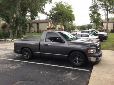

5/12 drop, 3" drop coils and drop spindles up front, in the rear custom leafs, flip and shackles, and if your going low you have to notch the frame, not sure if that's been said but it has to be done, oh and since you said your car was just over 2"+ off the ground, I measure out at 2" of clearance and yes I hit bottom in most places I drive
