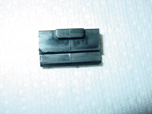

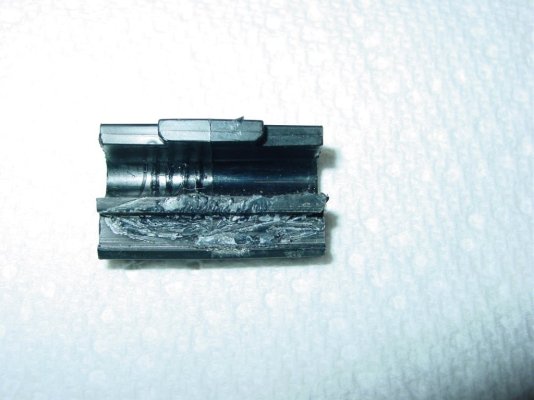

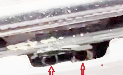

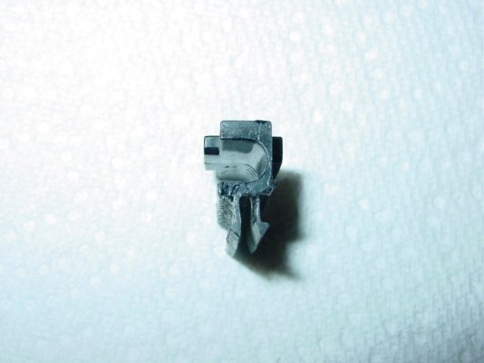

I'm hoping someone will confirm that I have opened the sliding rear window drain holes. I found two holes on each side of the channel under the cable guide T blocks which were a PITA to remove. I used a 1/8" or so wide x ~ 1/16" thick (each side) pair of tweezers sliding 1 blade in near the bottom of the drain channel towards the front, And then doing the same towards the rear of the channel.
I was then able to gently pry one side of the T block up a bit. And do the same on the opposing side.
There appeared to be some sort of adhesive but only on 1 side of the block. I'll will attach pic's of the block and the two holes under each one (L&R)
I cleaned the holes out with a paper clip and then a aerosol can straw adapted to a compressed air blow gun.
After doing the above I cleaned the lower window seal using the thin end of a bondo spreader running the fill length of the bottom of the window. lots of dirt and debris hiding in there. A fine design by some JO. I cleaned the inside slider channel as well.
puhing water in the 4 holes with a syringe had it coming out along the gasket as well as the 4 or relief slots
I did not find any holes in the channel under the window itself when open. So I'm wanting to make sure I did not miss them if there are any there.
hopefully the pic's and method used will help someone else wondering how to get the T blocks out as I was. DO NOTE the ribbing on the L end of the block which I believe is supposed to clamp the cable housing as it exits the block>
The drain holes are in the last pic.

My question may have gotten lost in all my babbling on the previous post
I'm hoping someone will confirm that I have found and opened ALL the sliding rear window drain holes.
I found two holes on the far L & R side of the channel (for a total of 4). They under the cable guide T blocks which were a PITA to remove (see above post).

I wanted to say I did find 4 more drain holes for a total of 8 drain holes total. they are in pairs at 4 locations. 2 are under the cable retainers at the far L and R of the channel.
w
ill try to find the video that helped me locate the other 4 and post it later
