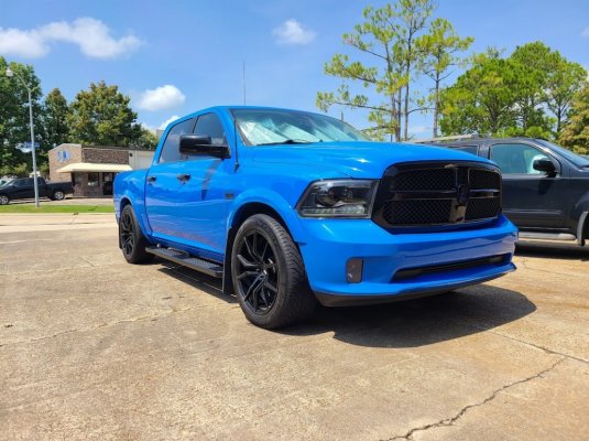

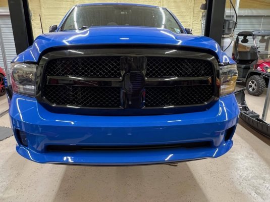

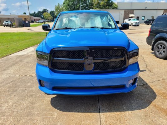

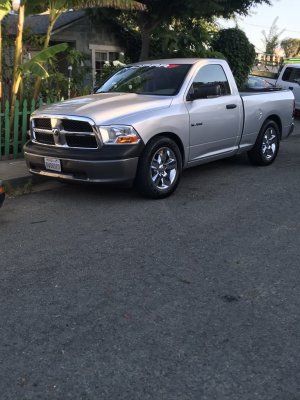

So, finally did the swap.
Was going to wrap it black or paint the chrome but man the sport bumper just looks so much better.
Plus getting a primered one sport bumper on ebay for $120 is pretty affordable. It's all the other parts that are not cheap. hahaha
I did found a wrecked express rams local so I was able to get the absorber and impact bar pretty cheap.
Boosted youtube video was very helpful too except there's more to getting the top painted part off. lol
Now, I have to get that ugly chrome rear bumper off and painted next. I think it would be cheaper to find a black bumper and get it painted.

Looks amazing. What parts did you need in all to complete this install? I'm piecing together the parts but want to tackle it in one shot.
BlownGP
Feb 10, 2013
6,142
1,696
Houston/Baton Rouge
Let's see
Trying to remember.
Sport bumper obviously.
Front Absorber
Front Rebar
Cower valence
Closeout panel
clips and screws
I got the rebar and asorber from a used truck and the valence and panel from amazon.
