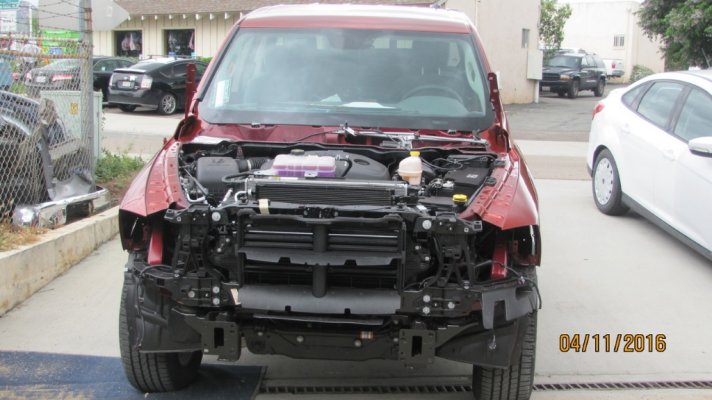

The fog lights don’t have brackets for the sport bumper. There are holes they go into on the large plastic bumper behind the bumper cover. You have to put them in before you put the final bumper cover on. They are held in by plastic clips.

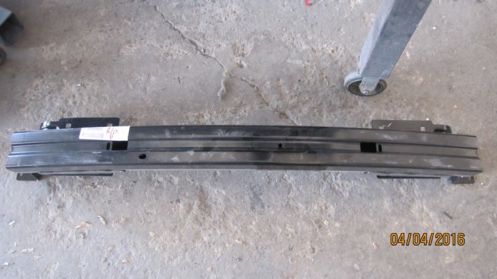

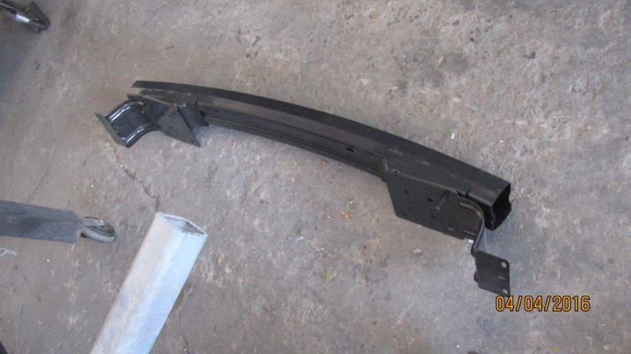

The big bolts they held the SLT bumper are used on the metal support for the sport one.
You can reuse the air dam stuff but I broke most of mine because the are plastic.
The corner bolts that hold the bumper to the corner are reused. Not much else because all the metal parts on the SLT ones stay on it.

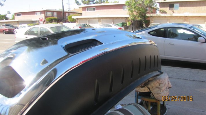

Now that this site has changed
We need to state what Year & model Ram that you are referring to
I can't figure out whether you all are modifying a 2009 - 2012 or a 2013 through 2018+
I have Chrome bumper parts for a 2016 Ram
I can take pix of the part numbers if they are needed
most of the tags are just as clear as this
https://imagizer.imageshack.com/v2/640x480q90/921/Tibo7y.jpg
