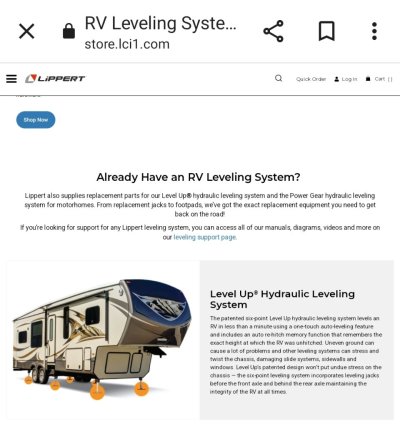

Where is your proof in writing that the tires on a side cannot come off the ground in a leveling event? All you were told and provided so far is to not rely on the system to remove tires and service underneath the rig.
These systems are not new folks, motorhomes gad them for decades. And guess what, I've seen plenty with the front tires off the ground to level it.
The point of the warning is Don't be a dummy and remove the tires and lay under it. That should be common sense but by reading posts lately it's not so common anymore.

And again, right off their website it states the system on unlevel surfaces will NOT stress the chassis.
" Level Up’s patented design won’t put undue stress on the chassis — the six-point leveling system incorporates leveling jacks before the front axle and behind the rear axle maintaining the integrity of the RV at all times. "

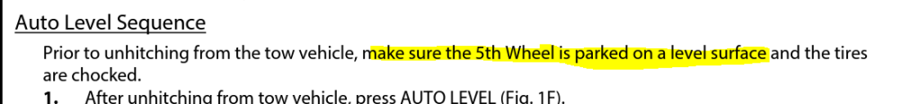

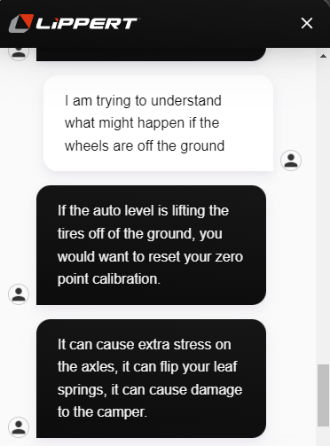

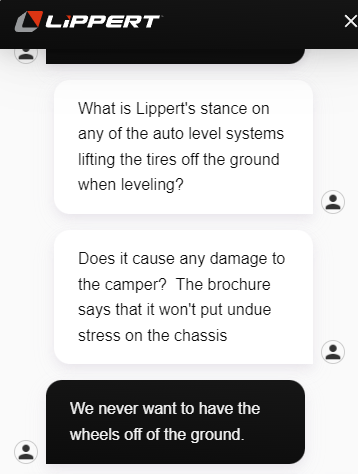

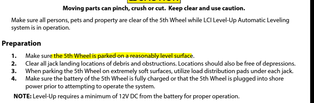

As I said before.... contact Lippert directly. They will tell you, in writing, not to lift the tires off the ground. The rear 4 jacks are STABILIZERS. They are not meant to lift the entire rig off the ground.
If you need more assurance that you're wrong.... see below. You're right though. I'm sticking the proof right in front of you and you're ignoring it for a brochure that explains how their system doesn't flex the chassis. Common sense is indeed not too common anymore.
Where in the snapshot that you posted does it specifically say that the tires can be off the ground when level? I'll wait......

So..... you're willingly ignoring LIPPERT specifically saying on multiple occasions not to lift the tires off the ground because you saw one with tires off the ground? I never said it wasn't capable of doing it and neither did anyone else. What I and Lippert both said was that you shouldn't do it. Big difference.
Anyhow I digress. We don't need to continue to derail the OPs thread. At the end of the day, follow the recommendations of the company who designed the product and everyone is fine.
