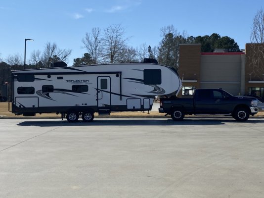

Thanks - Doesnt look like you have much rear end sag. Did you put install airbags? How do you like the AUH?
She don’t squat too much but I’m not fully loaded either, though both propane tanks were full in all those pics. I didn’t really pay attention to the order I loaded those pics, the last 2 were the day I picked it up (one at the dealership and one in my driveway), the “first” one is with most of our “essential” stuff loaded in there.
As far as the AUH, it suits my needs. This camper at max weight is 1/2 capacity of the hitch so I’m not as overly concerned as some with this hitch. Also of note, I did rotate the couple on the AUH to center the connection over the axle. This did bring the cap closer to my cab but I can still crank it 90* and maintain 6” of clearance. It looks darn close but it does clear! If you look at pic 3, that is with the coupler 4” back from the center. I thought it made it sag a bit more but they set it up that way for max clearance……….took more time to gather my sockets and torque wrench then rotate the coupler (super easy to do). That 4” make a pretty big difference, less sag and less porpoising with the pin weight centered, not behind the axle.

@Duece21 Finally made it to a scale! Now to be clear, my camper is not empty, it has what I consider a base load, as in the stuff I don’t take out (10x10 easy up, camp chairs, 2 full propane tanks, dishes, ext).
Pin weight of 1,580 lbs
Trailer Axle weight of 7,560 lbs
So a couple of other details, the 2 propane tanks are up front as are the easy up and camp chairs so that is a little extra weight transferred to the pin so I’ll venture a guess the listed dry pin weight on the 278BH is pretty close @ 1,321 lbs. We’ve got a short weekend trip in about 2 weeks, should have a decent load, the big heavily loaded spring break will follow, curious how the 6.4 will perform with a pretty full load down to the Gulf Coast.

I think you'll be happy, I have a Cougar 30RLS 5w and my 6.4 pulls it nicely. I live in NH and I've towed to North Carolina and back and also up to Maine. The 6.4 and 8 speed really work well together in my opinion. When I last weighed our truck and 5w we were at 18,400 combined.
Glad to hear it! Having previously owned 2 6.7 CTD’s I knew this truck wouldn’t pull the same but for what i pull and how often I couldn’t justify another diesel. For daily driving the 6.4/8 speed combo is very responsive and quite snappy, very enjoyable to drive around town.
My total combined weight from that trip to the scale was 16,340 lbs, we’ll add 1,500 lbs minimum at so I’ll be pretty close to what you were pulling when fully loaded.
