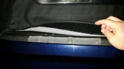

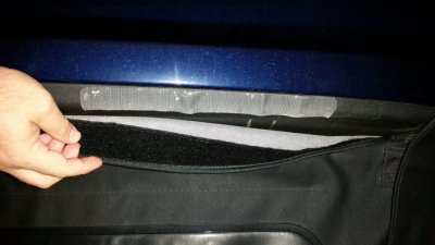

Then open the frame secure to the rails with the tether straps for stability. They hold the frame in place while you attach the canvas. Place the canvas on top of the frame and fold down all the panels. The front and back secure with velcro or snaps that you can screw into you bedliner. The sides attach with snaps on the rails.
The back panel has heavy-duty zippers that run vertical to attach to each side. The other corners lock together with prestiched velcro inserts. I was impressed with how well all the pieces fit together.
They include a bottle of canvas seam sealer that you apply inside over all the stitching to waterproof the cover. This is a needed step once the canvas is installed and has a some time in the sun to settle into place. We had have had a ton of rain since installing the cover and it has stayed nice and dry in the bed, even when traveling at highway speeds.
****UPDATE**** The seam sealer they provided did not hold up too well. I resealed all the seams with brush-on boot silicone and has been water tight now for over 2 years.
