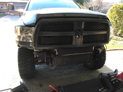

Here's a picture of the short control cable for my Warn Vr12. You can also see backside of my bumper and slim profile. I definitely can't fit it behind the bumper, but am wondering what other areas people have mounted their control box.
