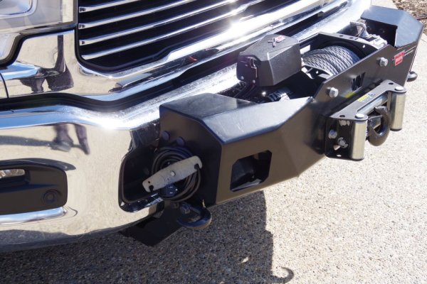

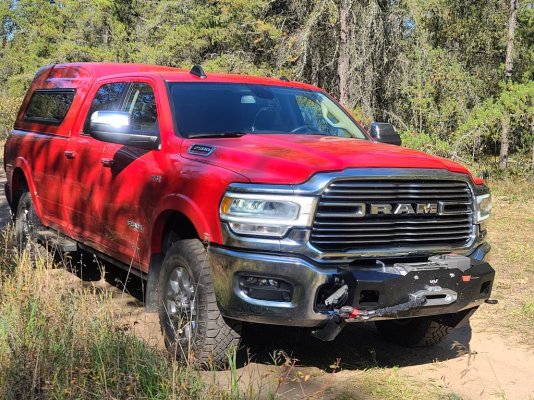

Either Bullet Proof Bumpers out of Red Deer. Bolt on, fully customisable, prices are Canadian so you pay 40% less and still no tariffs. (Bumper with a price of $3,000 Canadian, costs you $1,800) Or if you want to maintain your chrome bumper, use what I have, Warn Transformer. This one has a 16,000 pound Warn winch in it. Bolts to the frame using the factory tow hook holes. No drilling required.
I thought of you as soon as I saw his post, your setup looks very strong & like it’s made for using frequently, not just for show.
That looks awesome! I'm gonna check their stuff out now, thanks!
I personally have always like the full bumper/brush guard setups. I was looking at some of the Vice Designs and Warn stuff as well. Lots of guys running the cheap Amazon stuff but I can guarantee I'll twist it or rip it off once I hook into a heavy pull.
Yea there's a lot of good looking, affordable stuff that I wouldn't bolt to my truck if you gave it to me. I'm either gonna save money and spend time building it or spend good money to get a bolt on option.

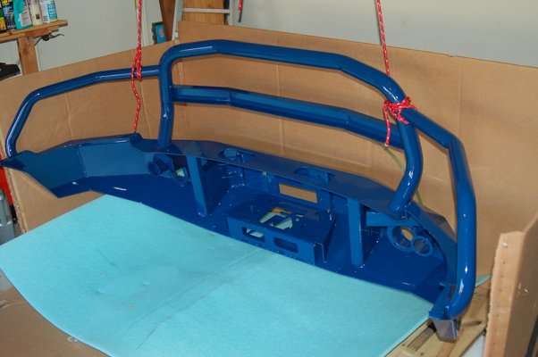

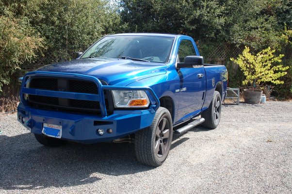

I have the fab 4's, and if I am being honest I am worried about heavy use in the long term, as it imo is too heavy for the 1500 suspension, perfect for the 2500. Bumper install is fairly easy, I used ropes and it made it rather simple. I like the approach angles and this is very stout, probably 50 pounds too heavy. I wanted an arb, those are literally Great bumpers if you can find one for your application, which I don't think you can. At the time this was one of two or three even available for the 1500, as you see the metal work under the headlights kept most bumper companies away, back then 2500's had all the bumpers available.

I've always been partial to the Ironman Raid bumper, if is for a 1500.
Looks well built, fairly light and the price is sure attractive. If you aren't pushing over trees, this looks like a pretty nice set up. Only thing is, I don't really see where the winch goes.
Other issue I have with a lot of winch bumpers, is you can't get at the top or back of the winch and you can't easily wrap the line on even because you can't see the top of the roll either. That was a big attraction to the Warn Transformer. If you are running line in and out 15 to 20 times a week, it is much easier to work with.
You bring up a good point and something I am trying to be cognizant of. Buckstop and fab fours both have full bumpers I like aesthetically. But I believe they are both well over 200lbs and that is not including the winch. So say 250-275. It's not a deal breaker, but it's not something to disregard. My truck is my DD as well so the added protection is a benefit, at the cost of efficiency and payload. Give and get. These full bumpers are all $2500+ now as well which is a big bill in the grand scheme of it all
I am looking at the warn site now. I do like the open top design for what you have pointed out. This is going to be more of a "farm tool" vs self extraction.
