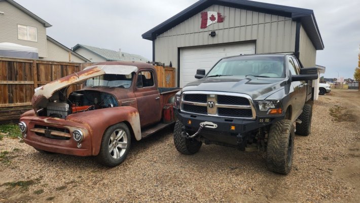

Chassis Unlimited and Ironman are the only ones that dont stick out the front for no reason.

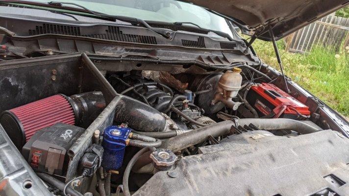

Odyssey H8 and 6.4L alternator is what I have and never had issue in the mountains and make sure you mount the controller box under the hood. leaving it in the bumper will just corrode it quicker.

The amount these bumpers stick out is comical in some instances. For the price I might just contact move bumpers and get a kit sent out and fab/modify it to what I want. Otherwise it seems options are slim still.

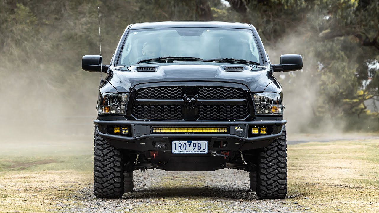

Vice Designs has their hidden winch kit which sits behind the factory bumper which is always an option as well.

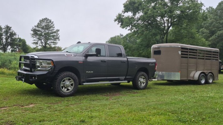

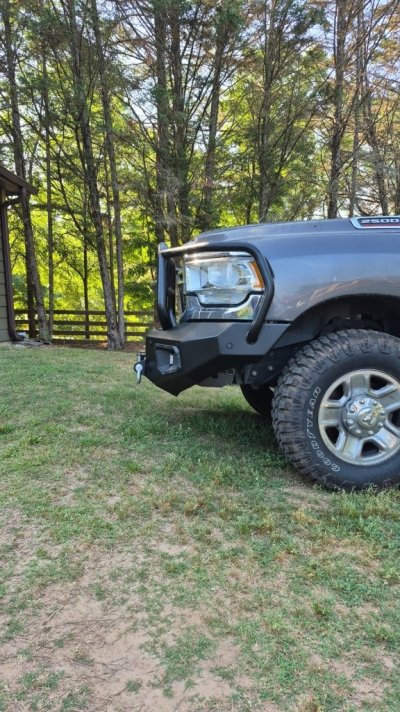

I know this is an older thread. I hit a deer with my truck a couple months ago and had a hard time finding information or photos of the winch bumpers online. I was wanting a heavy duty bumper and had it narrowed down to the Ranch hand sport winch bumper, buckstop bumper, or the warn ascent hd bumper. I love the buckstop bumpers but they were 12 weeks out on making one. The ranchhand and warn were both readily available. The ranchhand was cheaper but I ended up going with the warn bumper. It looks great. It's built heavy like the buckstop. It weighs over 300 lbs without the winch. 158.jpg130.jpg217.jpgIt will take up to a 18,000 lb winch. I didn't need that heavy of a winch so I went with a 12,000 lb winch. Got a good deal on the bumper and winch. Here's some photos for anyone else who may be looking for one.
