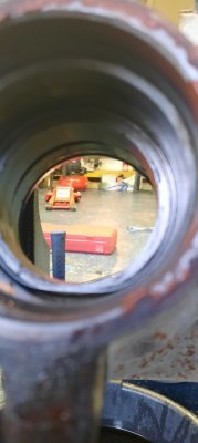

I destroyed the Dana 60 case on my 04 1500 4x4 and all i could afford was a used 9.25. I didnt notice that it was a 9.25 at first or I probably would have passed. My original plan was: Swap my carrier since it is a 3.92 LS and the donor case has 3.55 open diff. Now I have 2 questions:
1. Will a 9.25 take a Dana 60 carrier? They look pretty close to the same size. The LS seems just a little longer which I figured was due to the clustch assemblies.
2. My 9.25 does not have the groove behind the pinion races the most people I have seen use to remove them. I was able to get the out race with a slide hammer but there isn't a big enough lip on the inner race to get it with anything. Has anyone seen this? If so how do I remove it? Fire?

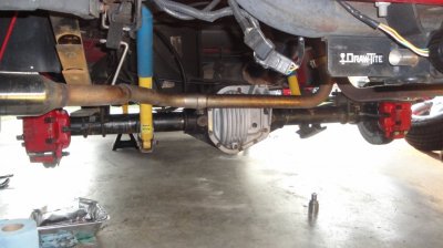

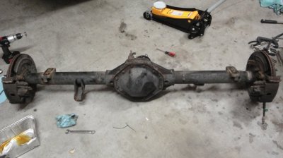

The 9¼ goes all the way back to the early 70's, one came stock under my '74 Monaco. There was a major internal change I wanna say in the 80's somewhere, but they're pretty much the same. 02-08 Rams they are identical except for some minor external stuff (bump stops are different between 2wd & 4wd) and the later 3rd gens when they started relocating speed sensors. This is a 9¼:
This is a Dana 60:

Thanks again Loanstar. How do I remove the inner pinion race though? I have everything figured out after that now.

Screwdriver and hammer. That's what I did. If that pinion race isn't pitted and Still smooth. I wouldn't worry about it. Mine was ****** up so I spent like an hour trying to bang it out

One thing is for sure, even if the pinion race looks good please knock it out and drive a new one in. New pinion bearings come with a race for a reason and it is because of the machining process and how they match the new bearing to the race. There is no way to guarantee the old race is an exact machined match to the new bearing. Even the slightest difference will cause early wear and potential failure.
