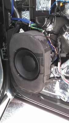

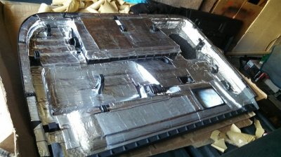

Here is how I deadened my doors:
2 layers of CLD as far as I could reach through the speaker opening. Sealed it and applied CLD on the door card, and CLD and CCF on the woofer enclosure.
100% coverage CLD on the door panel, and 100% CCF on the door panel.
