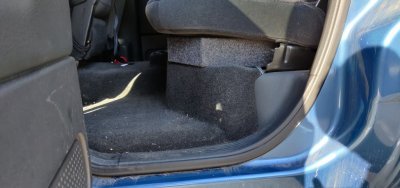

Today I embarked on my next fun project: Quieting down the cab from road noise. I assumed - correctly - that the interior has not previously been apart, aside from a previous owner installing two 10in kicker subs in a box.
Last week I purchased 3x36 square feet of Noico black sound deadening mats, and 2x36 square feet of their 130 mil red insulation mat. Everything showed up yesterday, so today I began taking apart the cab interior. Since the previous owners didn't really care for this thing... there was TONS to clean up. Some glass from a previously broken rear window as well.
Now that the first section of carpet and seats are removed I can clean, clean, and clean all the dirt and dust and install mats this week. My plan is to lay down the black mats along the ceiling, floor, rear bulkhead, tunnel, A/B/C pillars, and front firewall. If I have enough left, the doors as well. When all is said and done, it should drop the inside noise a few decibels and make for a more pleasant ride on those long hauls.

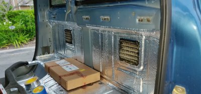

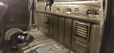

So far so good. More progress this evening after work. The rear of the cabin is almost done. I wanted to try the hardest part with the most compound curves first. I'll pick it back up tomorrow when I get the rear cab done, then start removing the front seats, amp, and headliner.

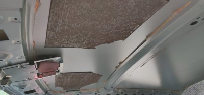

This evening I removed the headliner which kind of confused me at first, but was able to get it out by putting the front seats all the way back and taking it out the front passenger door. Then I saw these black mats on the ceiling. They're some weird oil soaked fiber and are super messy. I'll deal with them tomorrow.
The roof will get the Noico black 60 mil matting, followed by the Red 90 mil thermal barrier matting.

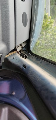

Side question, on the passenger A-pillar, what is this connector for?

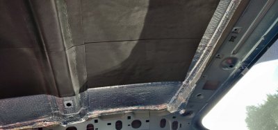

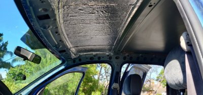

And now the roof is mostly done. Tomorrow I'll put the thermal layer on and clean the headliner, get it ready to reinstall and see how much quieter it is on the road. Then, removing the front seats and front carpet to do the rest of the floor, some cable management, and another thermal layer. It feels great to make some progress.

How did you deal with the messy mats that you found on the ceiling?

I waited until the roof was pretty hot from the sun, then while wearing latex gloves, I used a plastic putty knife to get them off. After that, thoroughly cleaned the roof with acetone. All the gunk came off fine.

Here's what the roof and back firewall look like with the thermal padding in place. It sounds so much quieter on the freeway - I can hear all the interior pieces, doors, and suspension rattles now. And my HVAC fan blower.
