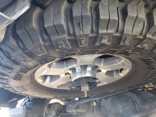

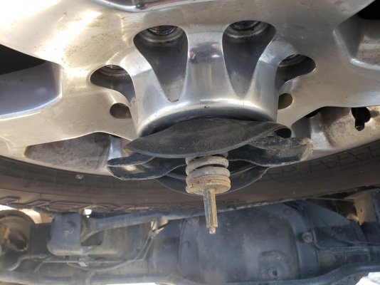

Here is my 35 12.5 18 Falken MT on OEM rim under the truck without doing any type of mod.

The 35 12.50R17 Falken MT is slightly larger in diameter by 0.1" than the 18".
