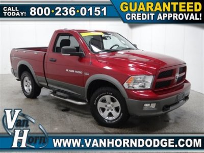

that's the first time ive seen a outdoorsman reg cab...didn't even know there was such a thing........nice truck

Thanks, wasn't easy to find that's for sure. What does dodge run for OEM speakers

If anyone is link timid
