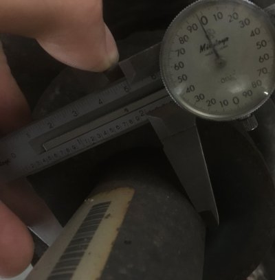

Is there anyone who has bilstein 4600 or 5100 shocks that also has a set of calipers who could measure the shock body? That would be greatly appreciated

Actually, I have both. I'll get some numbers for you later today

5100s measure about 50.4mm/1.98" in diameter just below the spring perch.

Thanks very much for the quick measurements. That’s actually very promising, the same area on my 2014 oem tokico is 1.997” and if people are using the oem spring on the Bilstein shock perch I have to assume the geometry is very similar to the oem perch, which would be needed to assemble the Eibach spring and shock.
My concern is due to the fact b-kt01-0000021 description say’s they are designed for use only with Bilstein products… although, I can speculate why they’d have a disclaimer like that.
Perhaps I’ll order some soon to dig deeper and report back what I find.FD4B9411-5951-4605-841F-98EF3F9ED430.jpeg
