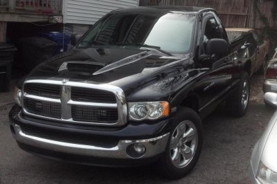

Hi everyone! I'm new to this site:wtf: Had a few questions I'm sure everyone who's wanted to lower their 3rd gen 4x4 will or have run into. I am doing a 2-4 drop on my '04 Ram. I have already purchased Beltech lowering leaf packs along with Beltech street performance drop shocks for the rear . I have lowering keys for the front but am uncertain if I require drop spindles or not. I also can't seem to find drop shocks for the front and am wondering if an OEM length shock along with a shock extender is an acceptable alternative. Greatly appreciate any input, thanx!

that IS an intercooler I see behind the grill. Neat-O!
I don't know about lowering a 4x, but in general, if spindles are an option, I'd opt for them.

And stop hiding that pro charger! You can't fool anyone here haha.

Thanx guys! Anyone ever use shock extenders? Pictures of the supercharger on my page. Also listed engine as hemi 5.7 supercharged
