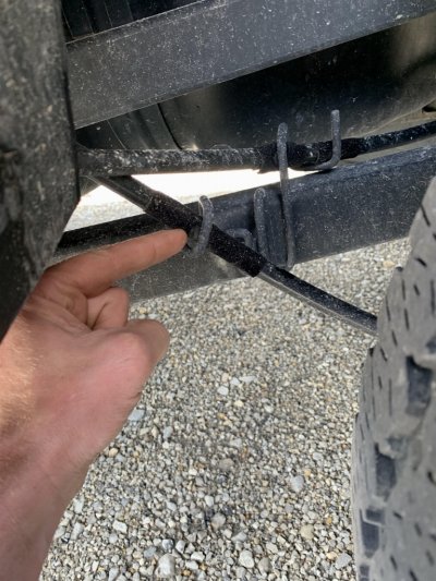

Did you check where the parking brake cable goes through this hanger? You can see in this pic that the felt coated tape is rubbed through, and will cause squeaking. 43XFqK4.jpg
I did.. I have wearing in the corner of that bracket though, I could see bare metal instead of the painted black. I did spray it down with some silicone spray yesterday but it didn't seem to make a difference. I just slipped the cable out of the bracket and let it do it's thing while I took a drive.
Honestly, I thought it made a difference as the squeak didn't start until 1/2 way through my drive, rather than 1/5 way. When I got home (about 3 mile loop) I went underneath and the cable was now pressing against the outside of the bracket. I wonder if it started rubbing on that and causing a squeak.

I just re-wrapped it in felt coated tape. I tried spray like you did, and it didn’t do anything.
I think I'm going to grab zip ties tonight, and hang the cable out of the way so it doesn't touch the bracket. I'll report back to see if it worked or not.
Talk about the saying of a picture may be worth a million words. I was looking at the thread as I have a torturing squeak also. Thanks to your photo my squeak is gone!!!!
After tying it up, wrapping it bubble wrap, etc... the squeak persisted. I don't believe its the parking brake cable. That being said I didn't even have a felt cover on it.. I just had the clear plastic covering underneath the cover.
