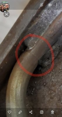

If I put a screw driver between pipe/cat converted and the brace (red mark in pic), the noise goes away. My next move may be to take a BFH to the brace and change its shape a little.

I just fixed the problem. The rod was cracked by the exhaust manifold/head flange, so I welded it. Amazing how much noise that made and the type of noise. I circled the cracked area but it was nearly impossible to see.
