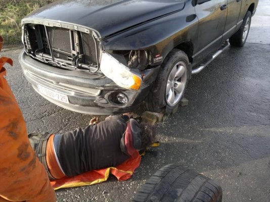

Bought a AIT srt bumper cover and it's a piece of crap DO NOT buy this product it has a bad fit and there aren't even any attachment points on the bumper to attach it to the original bumper.
But have to make do with what I have so I'm givin it a try to make it fit properly.
Could anyone who has a srt truck or a hemi with a srt bumper cover take a picture from the same angle as this one? That way I'll have an idea how it's supposed to look, in relation to the original bumper underneath and the wheel well cover.
General pic, think I should leave it in this color? :crazy:
If anyone has an tips/advice as to how to mount this piece of crap reasonably nice, please let me know!

are you mounting over a chrome bumper, or the bumper bar from a sport?

you have to remove your old bumper cover to replace it with your new bumper cover

Yeah you have to swap out the original bumper supports and put in the sport bumper supports to be able to use that bumper
Looks like your correct :-(

yea, and i think there are some additional supports in addition the sport bumper supports for the srt bumper

Does noone else see this? What is ur truck jacked up on? That looks crazy...be careful man.

lol...it looks like that jack stands are on the floor and maybe something else to hold the bumper up?
That's pretty scary. Do yourself a favor, return that POS bumper, and use that money to buy a decent jack, and set of jack stands.

look closer....it is on jack stands...lol
It's a festool box man, should be ok!!! :)
Jackstands are behind it on the frame rails, two jacks in front I used to line up the bumper :)
