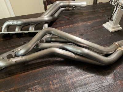

Hello all, I have been searching on here for a while now, and I hate to come in swinging but I needed to reach out for help. I am having a terrible rattle after installing 1 3/4 stainless works long tubes, and is pulling timing about 6 degrees according to Jay. I’ve wedged header wrap between the primaries/collectors, wrapped the trans lines and cinched them up, upgraded the exhaust clamps and had some connections welded while leaving access to trans pan for service, and retorqued everything about 5 times after heat cycling. It’s driving me crazy after such an expensive system. Dip stick tube is bent out the way and also wrapped just in case it contacts anything. The exhaust shop I bring it to says it’s resonance from so much flow going through the mufflex 24” single in causing the rattling sound? I’m looking into the j pipe just to try, I’m out of options. Help is much appreciated and sorry for the long post.

Check the little Stainless Works emblems that they spot weld on. Mine had a couple of broken spot welds and the emblem would make a vibrating/rattling sound.
I pried them off with a flat head screwdriver and some pliers. No more vibration.

I didn’t think of the emblems, thanks I’ll check tomorrow. Although the stainless works headers are supposed to be top of the line with ARP, between wedging wrap between primaries and collectors, and issues I’ve heard from multiple people I’m not so sure. And I am not one to slam a company it’s just that these headers aren’t exactly cheap.

If it's not the emblems about all that's left would be to wrap them with header wrap.I'm amazed Jay didn't tell you to wrap them.

Jay recommended to try and wedge the exhaust wrap between the collectors/primaries, he even watched a video I sent him of the whole system to see if something caught his eye. I pray that I don’t have to wrap them because it was hell installing these things. If I could go back I would have wrapped them while they was sitting on my work bench. :favorites68:

Ok so it may not be it but I had something very similar on my SW x pipe on my Mustang. Check you band clamps. There is that hour glass shaped spacer on the open end of the clamps that the bolts go through. 1 of the clamps that spacer cracked and half. It drove me nuts as it wasnt easy to see until I fully loosened the clamp, then I could see it was cracked. Plus the rattle sound would resonate through the entire exhaust so I couldn't pin point where the noise came from. I had some Vibrant clamps laying around so I swapped it out and the noise was gone.
I would go through each clamp and loosen them so you can spread the clamp and take the pressure off the spacer. Check the spacer then tighten it back down, then move on to the next one.

Thanks for the tips, I actually did upgraded the clamps and had some connections welded at the exhaust shop. Is vband clamps what you used? I am not apposed to changing them again if that’s the solution, does anyone recommend a certain style of band clamp and brand? Sleeve style? Lap joint? V-band? And I have the bolts about as tight as they will go on all clamps with and impact, hand tightened first to make sure the aluminum spacer in the middle sits right.
