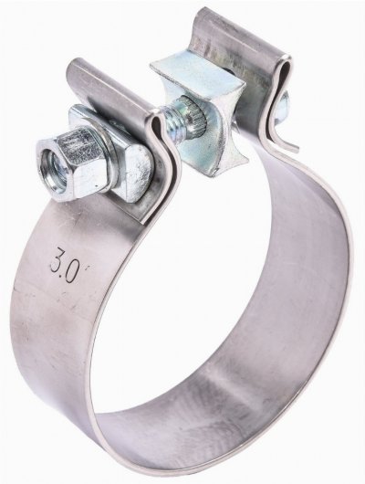

Thanks for the tips, I actually did upgraded the clamps and had some connections welded at the exhaust shop. Is vband clamps what you used? I am not apposed to changing them again if that’s the solution, does anyone recommend a certain style of band clamp and brand? Sleeve style? Lap joint? V-band? And I have the bolts about as tight as they will go on all clamps with and impact, hand tightened first to make sure the aluminum spacer in the middle sits right.
For my application I just used what was provided with the X pipe,
