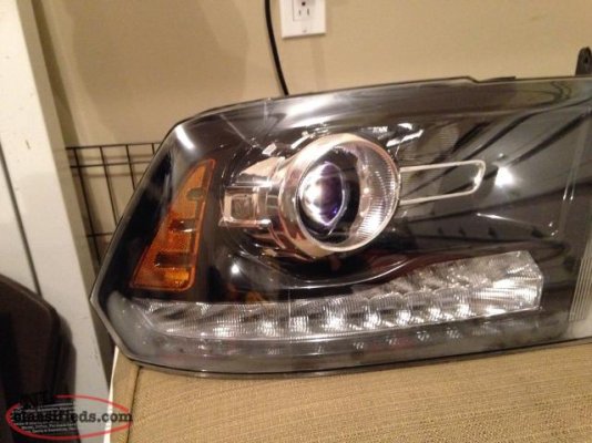

Two different style OEM headlights for the halogen bulbs, as described in the picture.
OEM projector headlight.
Very helpful thank you! Quad is correct then.
