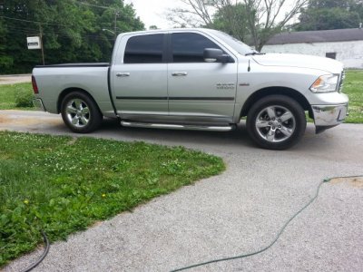

so after long debating and deciding to go down with the truck instead of up like i always do i went to air ride and got a bag kit for a 2wd and made it work for a 4wd because it fit right into place only had to modify the bottom plate for the airspring.
if i run the pressure airirde recomends it sits at the exact height i want the truck to be which is how i have it at the moment even though the front isnt lowered yet, if i run an extra 5 psi in the bags it brings the back up to match the front and airride told me today that i could do that with those springs. 20140530_151741.jpg
what do you guys think? any suggestions on the front and how low i would need to go?

would it be possible to buy the ground force lowering springs and make it lower with the mcgaughys spindles if need be im just worried only lowering it 2 inches wont be enough since in reality its only 1.5 inches. i would really like something like what green mamba has but i have read and read im willing to spend the cash i just want to do it a step at a time and make sure i get it level with the back at ride height

i cant wait to see the outcome. i am sure with a little fab you can make something work upfront.

Well, I'll take that as a compliment, thanks for taking the time to read my thread. If you want to bring the front down then you can order just the front GF springs, you just need to call them directly to order as they're not listed separetely from their kit. If you want to bring it down further then you have 2 options: getting another inch is easy by using the 2wd spindles and this won't/shouldn't cause any CV joint issues, or you can get the extra 2" (1-1/2"-1 3/4") with the McG's spindles. Once my front end settled I'm now just under a 32" ground-fender height with a 30.4" diameter wheel. If you go with the McG's spindles then plan on the extra $700 for the Kore CV joints. I now believe that the UCAs are optional at this point as the ride height upper ball joint angle is not as extreme as I'd originally thought.
My concern would be if you brought the front all the way down that you'll have trouble getting the back end to balance out without bottoming out on the internal bumpstops of the air spring all the time. I've been having this issue with mine and I'm finally swapping the air spring out for conventional springs, but I was running a spacer over a low compression height convoluted bag, I'm curious to see if the rolling lobe spring has less of an issue even with their typical internal height limitations. To match my front I only have an 8.5" spring ride height, and it's rough as hell.
Are/have you replaced the rear shocks? Do NOT buy the bell tech street performers for a 2wd, they are WAY too soft for the air springs, I would go straight to the QA1s, I've bought a set myself so I can get rid of the SP I have right now.
Looking forward to seeing your progress.

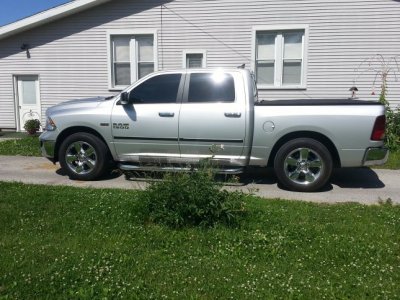

here is a pic of the truck with the bags aired up with the extra 5 psi sorry about the bush in the way

Don't worry about the bush, a little bush is ok, but that one definitely needs some trimming.
The air ride shocks are still cheaper than the QA1s which are $220ea before shipping so I'd go that route if I was you. The 305s should fit with little to no rubbing, but it is a wide tire and on a 9.5" wheel you MAY have trouble with the inner fender skin but I can't say for sure.

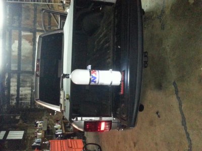

was working on how i was going to mount everything like the nitrous bottle, air tank, compressor, valve body, and extra batteries and i set the light down when i went to go get a drink and i saw this when i came back in. talk about a picture perfect oppotunity. the picture doesnt show it as well because of the camera flash but the light had the nitrous bottle lit up perfectly

So you've done the spider-truck mod? I'm impressed, lol.
