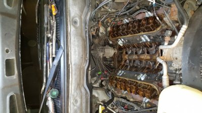

The 5.9 was losing 2 quarts in 800 miles, valve covers were leaking to. I got everything torn down, I fought the most with the stupid plug wire holders that go over the valve cover bolts.....now I'm trying to get the two front broken bolts out of the head from the intake, they broke off at the head of the bolt so I have a lot to grab but there not budging? Don't know why the pics are sideways....

Did my 98 earlier this year. Broke the same 2 bolts. 2 days of soaking with PB Blaster and a few heat cycles with a propane torch and still no budgy. Used my old arc welder to weld a nut on each stud. The welds broke, (I'm not very good) but I think that intense heat did the trick 'cause a vicegrip on the studs finally eased them out.

Well I got them out by letting them sit overnight soaked in PB, I heated them up real good, clamped a new pair of vise grips on, sprayed PB on it right after removing the heat, just worked back and forth the both came right out.

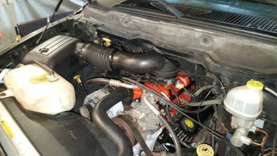

Got it all back together!
Can't wait to fire it up....

I love that orange paint! Which brand air box is that???

Thanks, it's the factory box for a 5.9l with a K&N filter.
