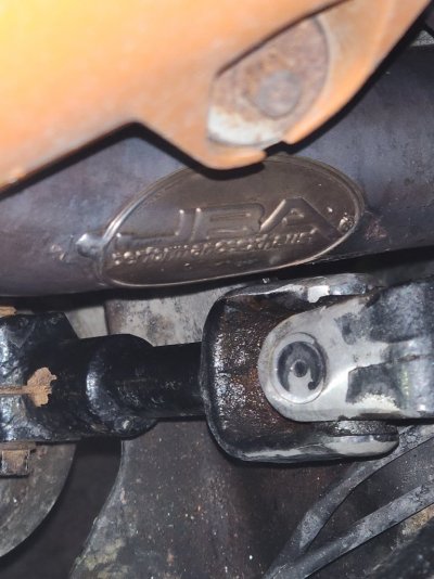

I'm trying to save myself from putting a nice dent in my cylinder 1 primary tube on my JBA longtube header. The steering shaft is hitting it. I have attacked the casting around the U-joint with a flap wheel and made it far less of an issue but it's still touching slightly. During my removing and grinding phase I found one of the caps puking a rusty dust and it seems to have a more bound up movement. So I planned on ordering a replacement. Before I buy another OE one and have to grind it down too, has anyone used the Borgeson 000953? How's the fitment with Longtubes compared to OE? Also, has anyone tried a 2500/3500 OE lower u joint on a 1500? Looks like the end closest to the rack is shorter which would move the Ujoint area forward and down from the header.

Being that close it looks like might also roast the lube and seals of that steering u-joint. Might be a good idea to add it to your maintenance checklist when doing oil changes.

You'll want a least a good fingers clearance between the knuckle and tube,otherwise it'll hit on a corner when you apply power and the motor rocks over on the motor mounts

Pull the wheel well liner out,use a long drift and at least a 4lb sledge,and swat the hell out of it,i'd pull the knuckle out of the way to.I had to dimple mine a few times till it had enough clearance it wouldn't bind on a corner while accelerating.With the knuckle / steering shaft out of the way,you should be able to get a torch in there to heat it a bit,as the tubes aren't all that easy to dimple cold.

I was going to say, if you don't mind doing some fabbing, it 'might' be possible to remove the shaft from the truck, cut the lower shaft and weld on 1.25" length or so to get the U-joint up higher than the header (and reduce the upper shaft equal length ..assuming you ensure the U-joints won't bind). Then weld or clamp and aluminum heat shield piece onto the header near the shaft to keep heat off the U-joint. Just a thought. Otherwise you'll be cooking u-joints.
My experience with aftermarket intermediate shafts has been so so.

Sounds good. And like I say, if you have (or get) a thin piece of aluminum sheeting like 18-20ga ...just a couple inches long in that region, ...you can fab it up so it stands off the header pipe near the shaft. You'd be amazed how much heat you can deflect back and keep the shaft from getting hot. You want to leave an air gap of at least 1/4" so air can flow between the header and AL sheet. All stuff you probably know....

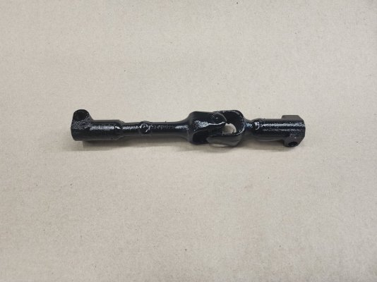

After some measuring and brainstorming I decided not to "add" to the u joint, but "move" the u joint instead. I cut 1.25" out of the upper section, cut and welded the 1.25" into the lower section. So the knuckle of the u joint will be above the primary tube. Not my best fab work, but plenty good enough. Lined up the index so my steering wheel should still be straight. But even if it's off a smidge it won't matter since I plan to get an alignment done anyways. Keep in mind this is u joint isn't great, so I'm not concerned if it doesn't work perfectly since I plan on ordering a new one in the future. But if it does work, I know how to modify the new one before I put it in the truck, if not, it's time to dent a header.
I'll get it installed in a bit. Gonna let the dusting of paint cure a little longer.

Flipped it both ways to see which was better. U joint above the header looks the have more clearance. But I'll know later today if it's enough or not. it definitely looks better already. Just not sure if it'll still hit when the motor rocks in the mounts. 20230225_033556.jpg

Flipped it both ways to see which was better. U joint above the header looks the have more clearance. But I'll know later today if it's enough or not. it definitely looks better already. Just not sure if it'll still hit when the motor rocks in the mounts. View attachment 514589
Take it to an open parking lot and make a couple sharp turns while accelerating slightly,if it doesn't rub doing that you should be okay.On my 14 it took a good finger clearance between the header tube and the shaft/knuckle before it wouldn't bind up the steering shaft,but i didn't move the knuckle up like you did,just dented the primary till i had clearance
I drove it home from work and never heard/felt it touch. But I didn't get to give it any moderate throttle because it snowed over night. But once I'm done with adding a glass pack to my exhaust I'll go for some testing.

Looks really good. Cast iron huh... Best I don't ask (and you don't say) what your welding process was. It's definitely further away from the heat. Try not to sit and idle the tk very long. Feel it for heat now and then to learn when and how quick it heats up.
