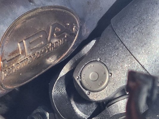

Update, very slight contact at wide open throttle while turning (minor curves on highway entrance ramp) but no contact at anything below wide open throttle under any circumstances.
I want to find an ACTUAL photo of the Borgeson shaft because the stock photos show using set screws. The factory shaft is Double D with a pinch bolt.

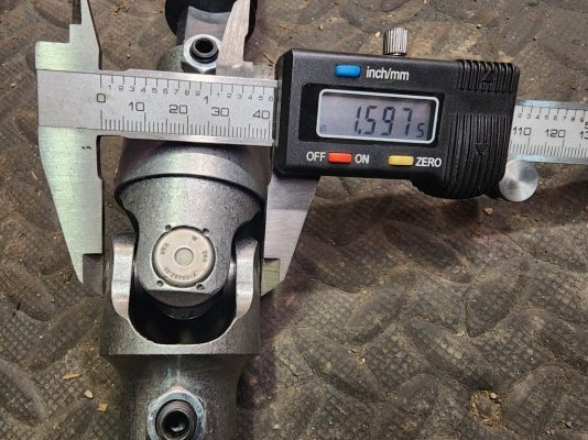

The Borgenson shaft does NOT help with clearance. The u joint is actually thicker than the factory one after I shaved it down a bit. (Probably same as factory un modified)
The Borgeson shaft will get returned and I'll order another factory one and re-do the modifications i did to mine now that I know 1.5" would be better than the 1.25" I did.

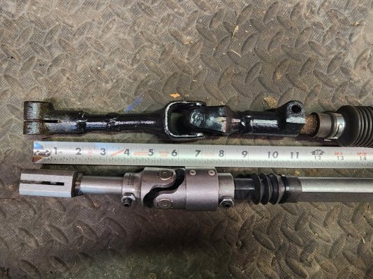

Another update for the sake of information gathering.
I tried to even flip the Borgeson shaft upside down mounting the rack side to the column. Made the u joint sit below the cylinder 1 primary. In turn making an interference with cylinder 3 primary. Also fitment on the rack end was subpar. I'd imagine I could cut and extend the lower section of the shaft just like the stock one I did. But modifying a $340 steering shaft didn't set well with me, just like whacking a $900 set of headers. So looks like chopping up a stock $50 shaft is going to be the best option. Soon as I get the new one I'll chop it up and modify it better than the current one I'm using.

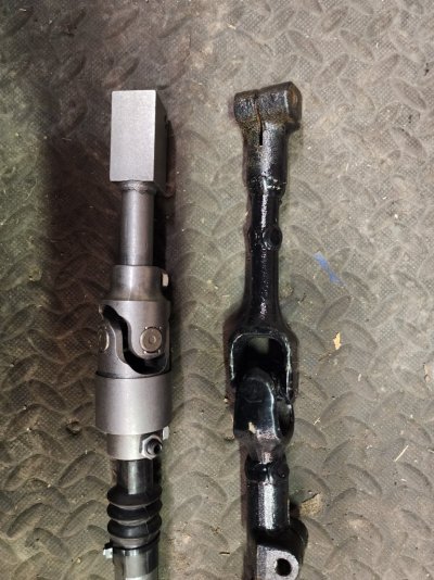

Couple other quick pictures I took before boxing up the Borgeson to return.

Interesting...
Thanks for the pics.
