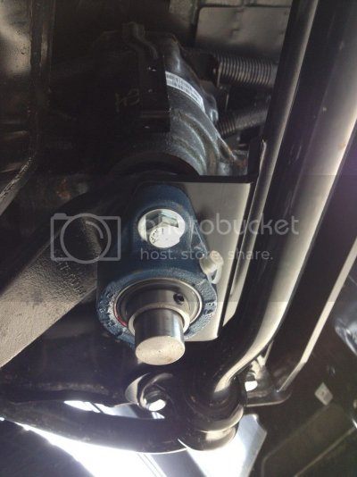

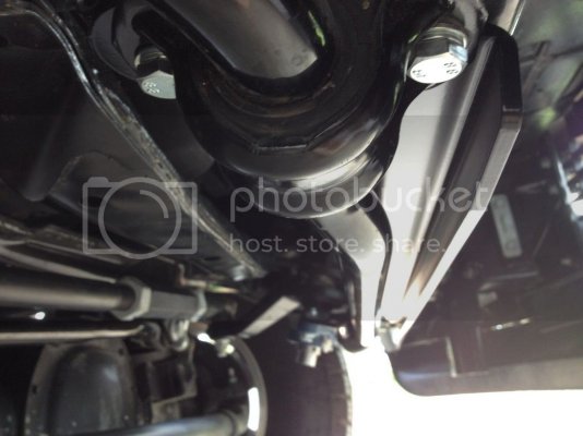

Well I finally had time to put the stabilizer under the 2500. I know my tires arent that big, not "off-roading" like lots of guys are but figured it was cheap insurance for the steering box just in case.

Yep, cheap insurance. The steering boxes on our trucks have a reputation for premature wear so adding the brace is a good idea. With 14 inch wide tires, I'd figured it would be a good idea to add one.

There are many different brands & styles of this device, and on many truck sites even mentioning these things will start a debate-war similar to the ones you see about what motor oil to use. After looking at them all, I decided on this one:

As long as it doesn't mount to both frame rails you're good. If the brace can flex with the box itself and not torque the sector shaft it'll live a long happy life.
This was a huge deal on he 2nd and 3rd gens. People were buying those $99 braces to 'stiffen' the frame but the steering box still failed lol
Edit: just looked at the pics on the link you posted. Your pics didn't look like it went to both frame rails. Be careful, for the reasons above.

I cant speak for other people, but Im not looking to stiffen the frame, only to keep the shaft coming out of the steering gear from moving away from its intended centerline. The pitman arm realizes excessive side-to-side load due to larger tires and the geometry of straight front axle linkage that transfers load to that shaft. All I want from a brace is to help keep the shaft centered and not being pushed side to side by the lever effect of the linkage.

I completely understand. I'm not saying they don't work. The frames are 100x stiffer on these trucks than the 2nd gens. But it looks great brother, clean install. And thanks for the link!

I cant say whether they will work personally, never used one before. But I do appreciate your input and feedback, everyone has something to bring to the table when discussing this kinda thing. I guess putting this on may be $100 snake oil, but I figured I would put it on there and just see what happens. Im not an off-roader making the linkage articulate all over the place, just use the truck towing trailers and regular farm/ranch type work.
If it turns out to be a problem you guys will be the first to find out ! :)
