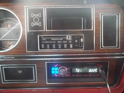

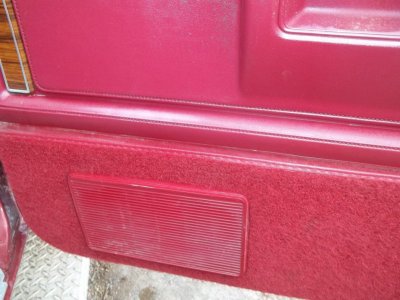

My 85 had the factory am/fm stereo that only worked on AM and only half the time. So I yanked it in favor of an Alpine head unit w/USB and aux. jack. The factroy setup had 2 6x9's in the doors and 2 box speakers behind the seat. Adequate enough, but I had a pair of Pioneer 250W 3 ways just layin' around, so I swapped the door speakers for those. Welcome to the 21st century!!

Looks like a nice clean installation! How do you have your GPS mounted? Did you just put the mount in the cassette cubby? or is there some kind of special bracket holding it up?

GPS sits in cubby and attaches to side glass with suction cup. Nice to have that technology in a 28 yr old truck. Was only $60 at Walmart. Wiring and mounting kit for stereo available at local parts store for about $20. iPad plugs into stereo. Chrysler used the same radio in cars and trucks for almost 30 years!! Makes for very easy install with no mods.

The speakers are Pioneer 4 way 250 watt. They are plenty loud!! The deck is an Alpine that I picked up from Best Buy. It has USB plug and Aux. plug. It was only $80. The speakers I bought at an auction NIB for $25. They fit nice in the factory openings. I used the factory speaker wiring.

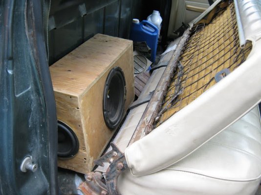

Side question, where is your sub and what size? I was thinking of putting one behind the bench seat, and I know a box I could put a 10 inch in, or a couple 10 inches.

my sub is behind the seat. it is a 10" and puts out more bass than my truck needs. i usually have it turned down as low as it will go and it works pretty good for me.

Thanks for the picture, that helps out alot! I'm young, so I don't think the bass is gonna be turned down ;)
