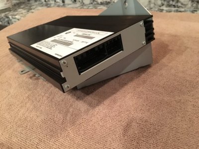

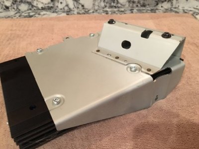

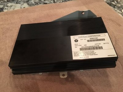

Fixed!
Well... it was the amp.
Traced every ground and they all looked good. Removed door panels and inspected speaker terminal connections and they too looked fine. Traced the wires through the door passages and none were stripped or bare.
At that point we changed the amp and everything is now good to go.
So now... question is... anyone have an idea where I could have the original amp repaired? Might be a good idea to keep around for a backup or help another forum user out.
Attached some pics - not a small amp! Yet it manages to fit in the sidewall right behind the emergency brake pedal.
