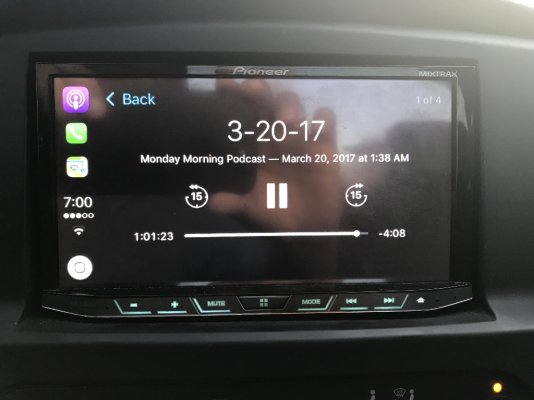

Pioneer AVH NEX series. You can do Apple Carplay or Google's Android Auto. You use the GPS from your phone (by plugging it in) and it will switch over to a backup camera feed (Apple only lets you use their maps, but you can open Waze in the background for audio notifications). You can adjust the lines on the screen for a backup camera.
You will need the wiring harness, antenna adapter, a Metra Dash kit (to fit the double DIN head unit), and the radio.
I have the 4100, here is the newer 4200:
https://www.pioneerelectronics.com/PUSA/Car/NEX/AVH-4200NEX
I love my radio, every once in a while on CarPlay, it crashes and restarts (maybe once a month to once every two months), but does so very quickly,

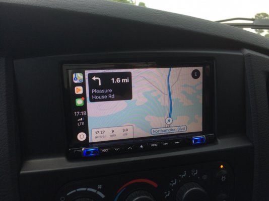

Concur with above. I’ve got the Alpine ilx-207 with CarPlay. Live it!
CarPlay - pandora (can thumbs up from the hu), Spotify, google play , Apple Music, IHeartRadio - all controlled from the hu.
Reads your text messages
HDMI
USB
AUX
Bluetooth
Pretty solid DSP (you can control cross-over, speaker timing, equalizer, separate sub controls)
Back up camera capable
“Voice” button couple SIRI
.,.and I’m not saying to do this, but you can instal a parking brake override for full functionality while driving. You can even watch a streaming football game on your ESPN app while connected to hdmi.
