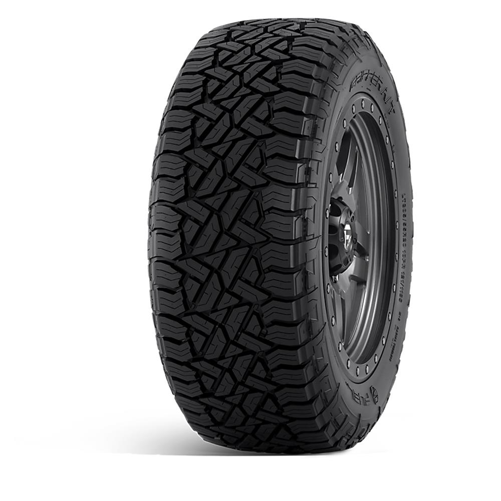

Can my 2021 5th gen on stock ride height pull off a set of 22x12 -51MM on 325/50 tires?
Tire-
  • 325/50R22E (35"X12.75")
  • FUEL GRIPPER AT ALL TERRAIN TIRES
Thanks

Hey, the tires are

According to Summit Racing, Fuel Off-Road Gripper in the 325/50-22 size are 34.8" in diameter. I don't know your stock tire width but at 325 plus 34.8" in diameter, I'm going to surmise with stock wheels you are going to experience some rubbing while turning. Perhaps a wheel spacer could minimize the rubbing. Just my 2 cents.
