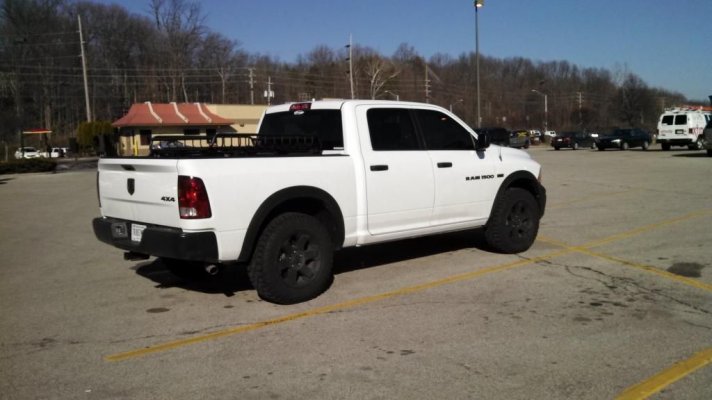

I think you can fit 295/60/20's without any issues leveled.
there are a lot of members with MT tires on the oem 20's.

285/60/20 goodyear duratracs on 13 sport 20's, no level, no rub, no issues
[/URL][/IMG]

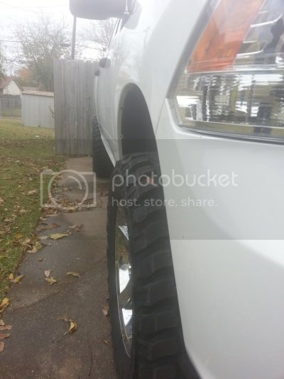

Mcginnis
Feb 21, 2012
104
29
Forney, TX
20131201_150954_zps3d7b3186.jpg'm running the stock chrome clads with 35s and 1/4" spacers. Still rubs a little at full lock

It looks really good McGinnis. I have the sport wheels and love them, and if I could fit 35s my truck would look perfect for me. But I'm just too worried about running spacers.
These trucks look so good with the stock wheels and MTs though
