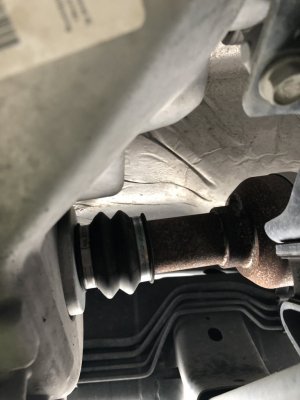

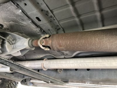

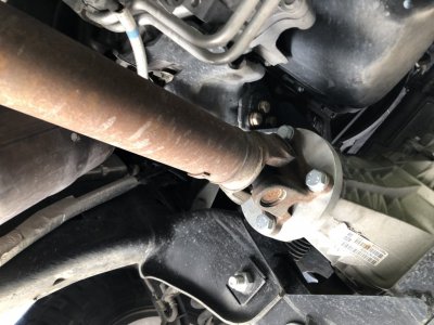

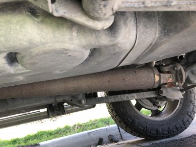

angle finder.jpg Do a google search for "proper driveshaft angles". This will give you some working knowledge. Your pinion angles might need to be adjusted.
Posting while you did as well.
The Rzeppa joint angle doesn't look good. Angled too far down for my liking.
In the front it is always a trade-off between caster angle and pinion angle. Do the best you can do there.
Get a magnetic angle finder to check your angles.
