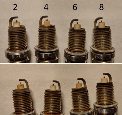

Another update. I haven't been able to do any testing or get readings. Been way too busy, and fighting the weather and free time alignment issues.
However, I did go ahead and switch out the plugs from the Iridiums back to Copper. The Iridium plugs didn't look so good, at least to me.
Here's what the plugs look like. I think I got them in the right order.
These plugs have less than 30k miles on them. I think less than 20k actually. They look a little rough to me for such short life. Plug 2 & 8 look like they have melted spots on them. I haven't been able to tell if the pulsing has stopped yet. I'll have more time to do that tomorrow, I hope.
