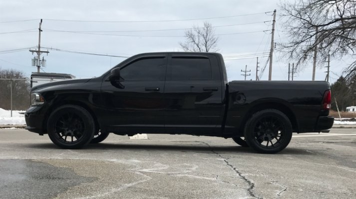

Specs?? 4x4? Sits perfect!
Thanks.
It's a 4x4. 305/45r22's
Ground force 2in front springs trimmed a 1/2 coil off.
Belltech 4in rear drop kit. With 3/4 spacer and airlift bags. (I didn't want to rear to squat, and I like a slight rake.)
Now I'll start getting sway bars and all that stuff.
