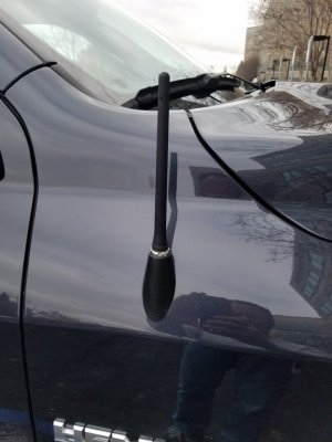

I have the same one from the Antenna Source and initially didn't like it so I put a standard style 10" mast on, no better. Went back to stock mast and hated it! Put the stubby back on and really tested and realized it's just as good as the stock for me so on it stays. What bugged the crap outta me was that it didn't cover the black post on the base so I fabed a post cover using a large plastic screw cover. Hard to tell it's not the antenna now.

Do you have any pics? It bugs me too, so I’d like to try the screw cover but I can’t picture it...

Ran out and took a quick pic
Go to the hardware store and buy a screw cap cover.
These come in small and large size, you want large. Cut off the cap and enlarge the opening to fit over just the small chrome portion of the post. If i remember correctly a 15/32 bit is exactly the size and I used it like a hand reamer and trimmed with an exacto blade to fit. Turn upside down and fit over post and install antenna.

You sir, are a genius. Headed to Home Depot now!

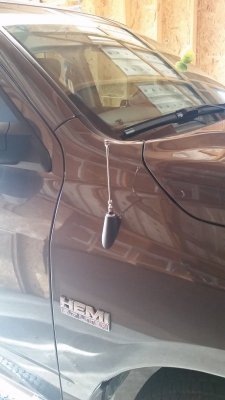

Since I don't park in underground parking structures I did away with the stock mast and went with this one. Love the look of it and the reception is as good as the stock mast. 20170607_185126[1] (450x800).jpg
