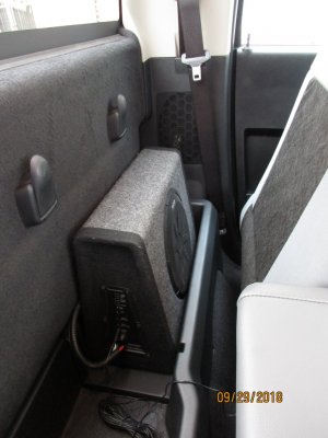

I pulled the tray out of the back and built a ported box behind the driver's seat. The sub was directly behind the console. Or you could get a powered hideaway sub for under your seat. Depends how much boom you want.

I seen the fox box, but you do lose the storage box. It almost looks like there should be a sub that slides in the storage box similar to the srt10’s.
And what’s up with that seat belt back there?? Mines missing and there just a hole in the back of that cover

I have the 10in version of this. Puts out nice clean bass. It fits directly in the stock storage box behind my seats. I didn't want to lose the storage box. Amp is under my driver seat so wiring is very minimal

Rockville slim-line powered sub?
Under seat or behind back

I currently have this 10" Kicker Powered Subwoofer in mine. Also you can always have a stereo shop build you a box for a 10" or 12" subwoofer.
