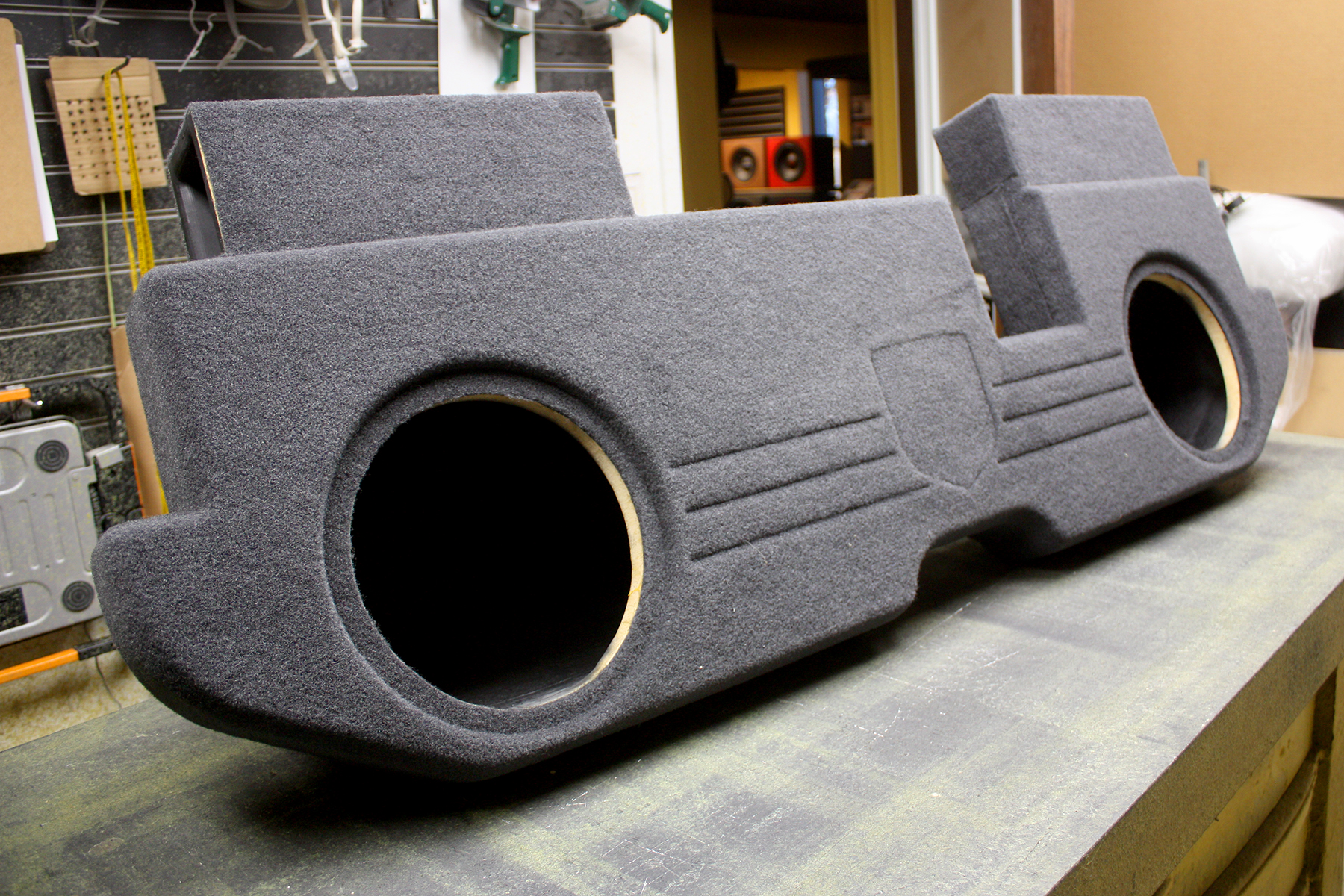

The Kicker Comp R's like between 1.25 and 1.75 cubes airspace, so this box would sit well with them:
For what its worth, I have heard this box with JL w3's, and I was very impressed. I am putting 2 Image Dynamics IDQ12's in mine next month, along with the CDT unity 7.5 kit from CDT.
