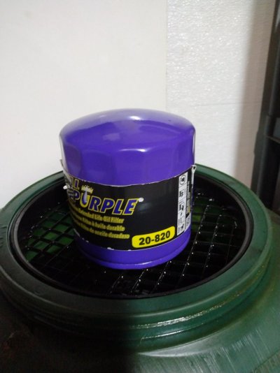

Just did an El cheapo (not El Chapo) oil and filter change for diagnostics... At speed pressure back to 51, warm idle back to 30. I have always changed the oil in June with full synthetic and a royal purple filter. I had under 8k on that oil/filter. WTF? Piece of crap.
I had my suspicions, you guys confirmed it. We can all rest a little better tonight.
LOL thanks guys.
LOL thanks guys.
Glad to see your issue cleared up. However, that idle pressure is still a bit low overall if its normal. One current, leading theory around the infamous hemi lifter failure is high idle hours and idle pressure in the 30's. Tuners can bump up idle RPMs to increase idle pressure into the 40s
