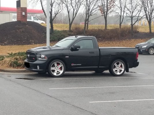

Hemi 5.7, supercharged
Op don't worry, your ram can be supercharged but it's the next component to fail that will get you. Like transmission rear end etc.
Questions, assuming you have a 5.7 hemi
What transmission do you have 6 or 8 speed in your 2013. How many miles on your engine? Have you experienced cam and lifter failure, ever?
The good news is, with a 2013, your engine computer is unlocked and can accept a tune if you go there.
As to kits. We'll there is a few. But let's get basics down before jumping into the issue
PS, my 2014 is supercharged and has held up for 80k. With limited issues.
